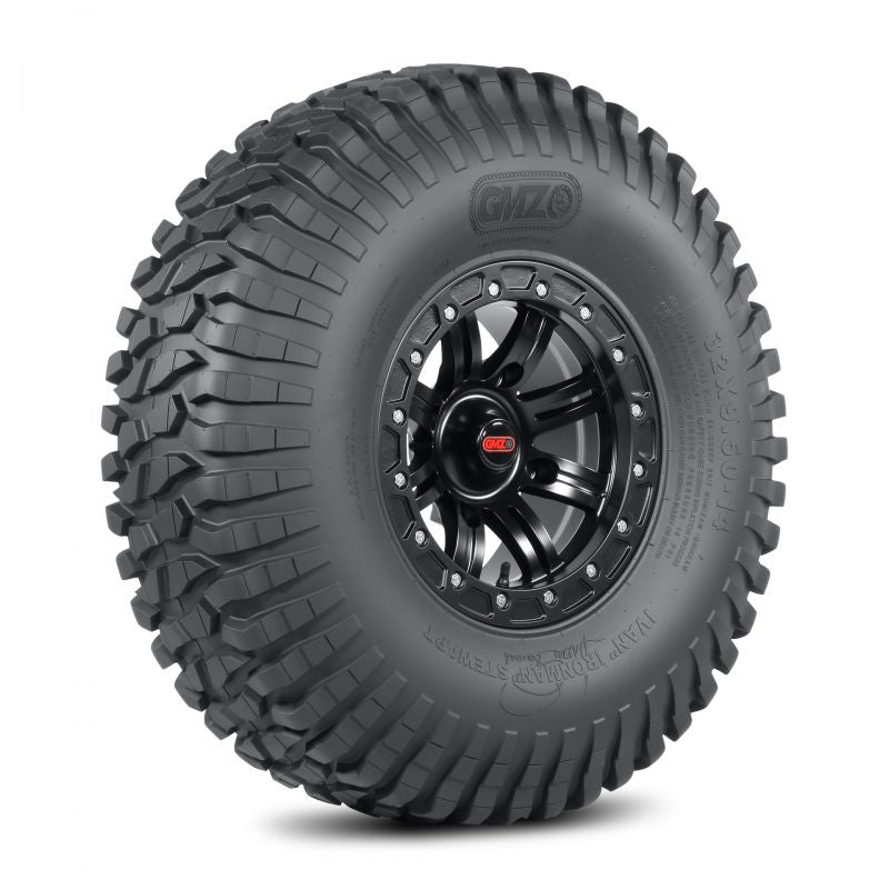

Did you get these tires? Thoughts?
That tire has been around for a while. I have not tried it. I have seen them and they look good.
I’m curious as well. Anyone with 33s have some insight as to how much room they have?
I have a 64" X3 XMR. Base before tires was 15" of ground clearance on the stock "30" Cryptids. I installed 33" ITP Versa Cross V3 on 15" 4/3 wheels and I have ever so slight rubbage mid inner fender under full turns, which doesn't affect performance at all. It also does not get any better or worse with suspension compression/extension. It just leaves a little shiny spot. this rubbage would be slightly worse with a 5/2 wheel (which I'd recommend over a 4/3) and might rub moderately with a 6/1.
