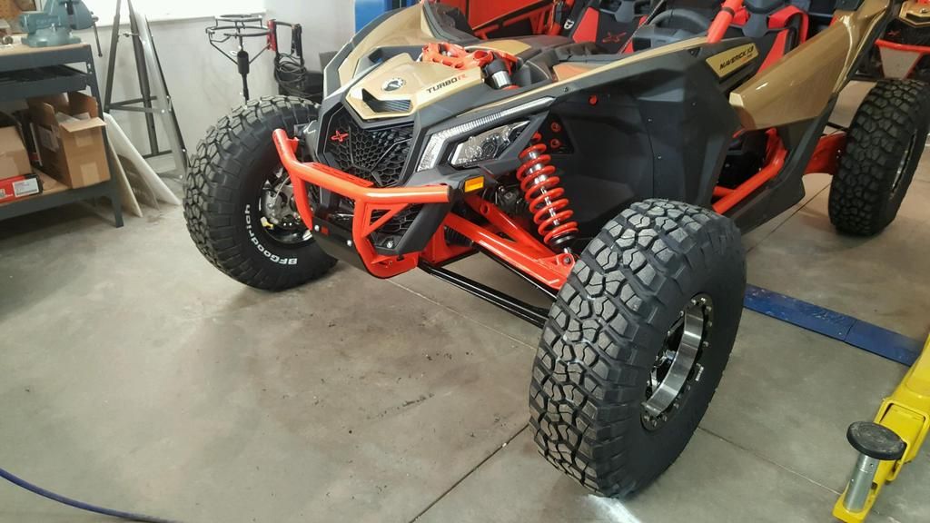

Got my Chicane Rx tires today, 32x10x15, along with STI HD5 BL wheels. Tires weighed in at 47 lbs per. Wheels were 16 lbs each. I will see what stock tire and rim weigh when I put it all together. Buried under snow here so it will be a few weeks for sure. Can't go fast enough. Dropped it all off at my buddies garage, put the tire up against his 2015 XRS Turbo with 28" Bighorns and my F350 with 18" tires just for comparison, lol.
