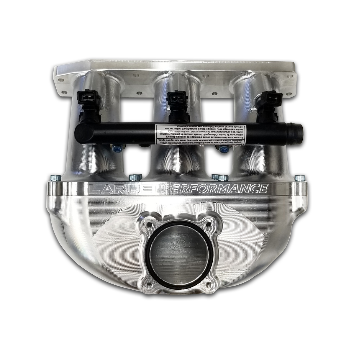

If the OP is running high pressure I would go billet from LaRue or Whalen.

So it comes down to buy a machined aftermarket plenum with a center intake for a balanced charge. If you are going after 300+ hp get a 6 injector model.
