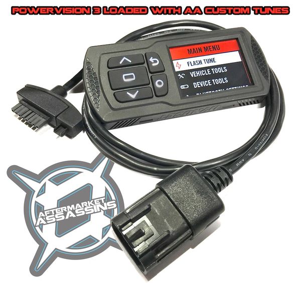

your keys are not the problem
when in limp mode read the error codes
for 17 you will use the headlight trick to read codes
or a tool like pv3
the error codes will tell you why or what is wrong
to read active codes the cel must be on
the headlight trick is not easy, the instructions are in the owners manual
it always takes a few tries before you can make the trick work
here is one of many videos
