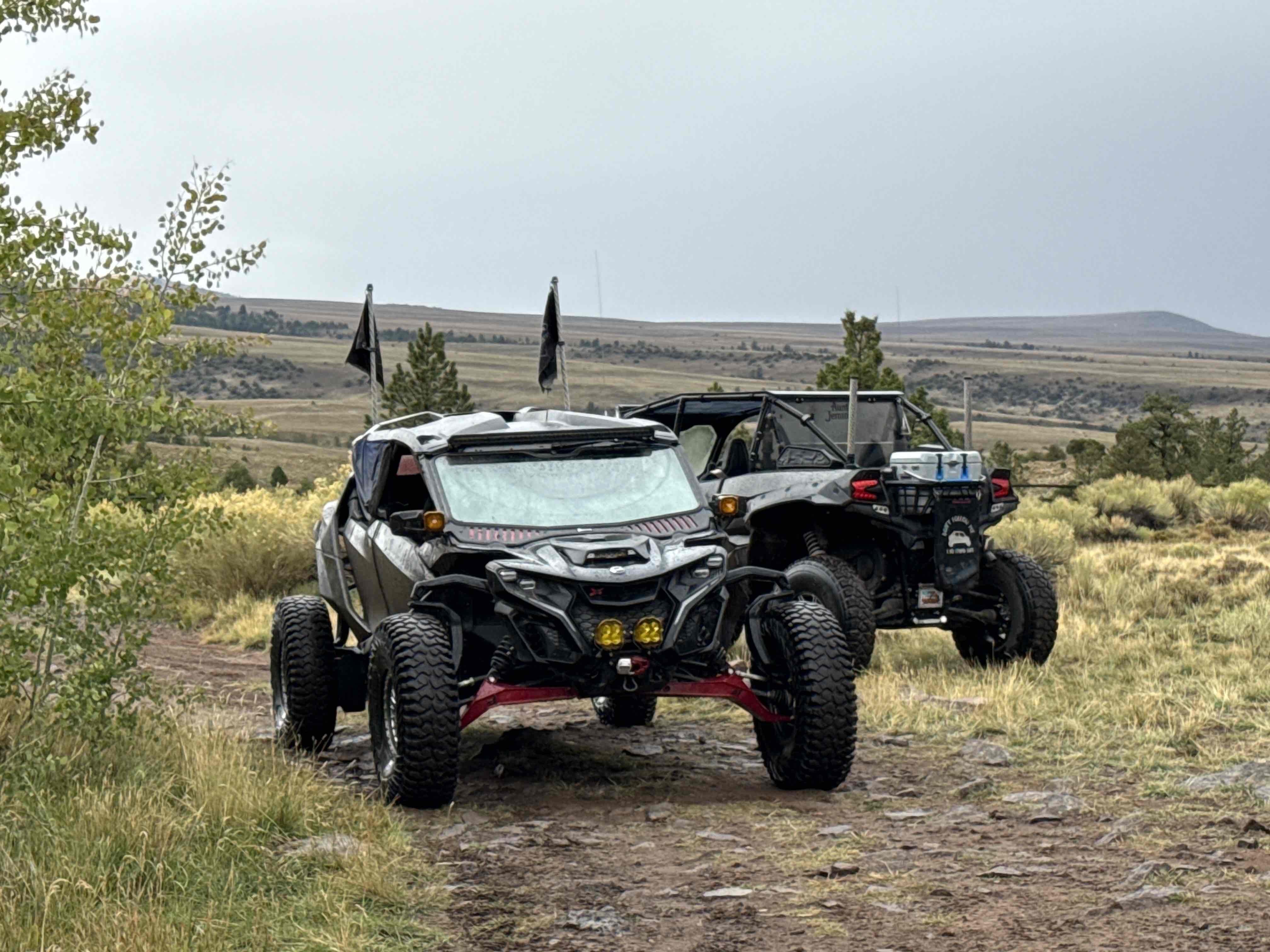

Been busy. Got my CT raceworx lower a arms installed last week. Getting ready to head to trail hero to guide tomorrow. Stoked to spend some days on the rocks! For those of you that have also done the CT arms. How are you routing the brake cable. They have 4 holes threaded in the arms but the brake lines were way to tight for all 4. I got the bottom and middle and felt that was ok.
Also changed all my fluids last night. So worth it to just drop the skid plate and not deal with oil running all over! While I had the tires off I did pinch the brake pad holders a little tighter and it seemed to help a bunch to stop the rattle.

I’m out of town for work but just did my lowers and will send you pictures. I went under the arm by the caliper and tucked them in as tightly as I could. It is a bitch of a job to replace the cable with so much needing to come apart to get to the rivets and attachment points. I was able to get all the hose clamps on but the driver side was tight at the last clamp before the fitting mount at the frame at full droop. I was able to work a little slack to it and cycle the suspension fully but not sure if I will leave it like that.

Thanks. Yeah at full droop it was way too tight for my liking. And the. You add turn into that and it was really bad like it would break the fitting on the frame scary so I didn’t do the top hole at all and just have the two
