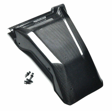

FourWerx Carbon Can-Am Maverick X3 Carbon Fiber Center Hood
www.utvsource.com

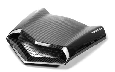

FourWerx Carbon Can-Am Maverick X3 Carbon Fiber Engine Hatch Cover
www.utvsource.com

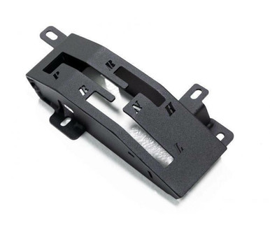

Quick Shifter Gate
(For Photo see page 20 Reply #385)
UTV Source carries the best UTV parts and accessory brands in the industry. All the best parts for Polaris RZR, Can-Am Maverick X3, Yamaha YXZ, and more.

Quick Shifter Gate
