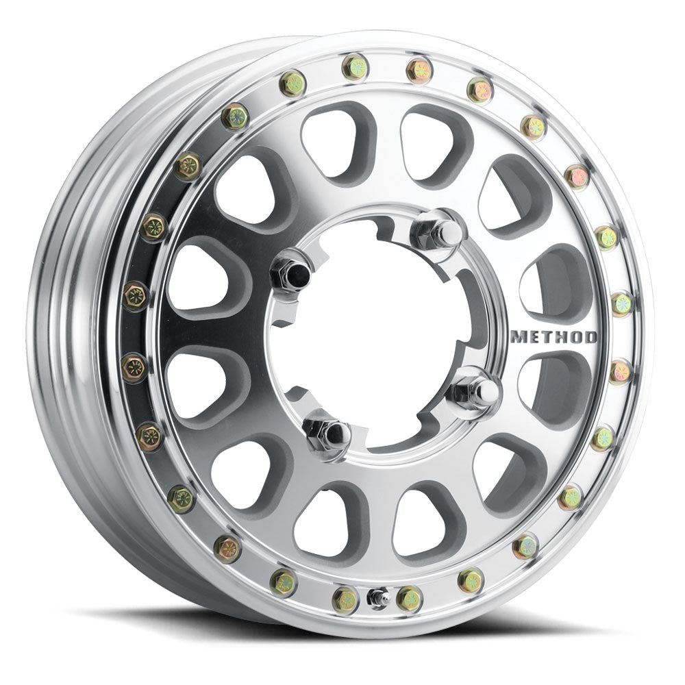

Hello,
I have a 2021 X3 RS Turbo RR( (72"). I plan to run 32" tires instead of the factory 30" tires. It seems that the most common approach is to go from 14" to 15" wheels to accommodate that.
I like the Method 401's. What size/offset should I order to maintain the same track width and suspension geometry?
Also, I ran a few different keyword searches and couldn't find solid information.
Thanks!!!
#3 ·
As close to stock as possible which is 6+1 in back 5+1 front. Most run a square setup so you can rotate tires and only need to carry 1 spare. 5+2 aren’t bad either but will make it a bit harder to steer. Measure your trailer before either way. Also pay attention to tire profile as it will make your car handle different
#9 ·
I went with the 401s on the high offset based on shock therapy recommendation. It’s skinnier wheel but keeps the closest centerline as compared to stock. I mainly trail ride fast so it works well for us. Hope this helps
