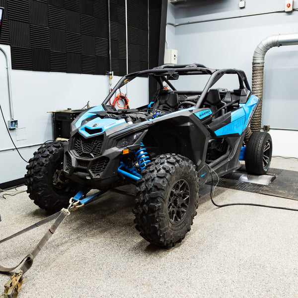

That information is not accurate. Evolution Powersports has been tuning the X3s with the new ECUs for quite some time now. I'm surpised people still continue to say nobody can do it, Evo has been doing it for a while and the info has been out there. They have several options currently available for your machine. You can see them here:
