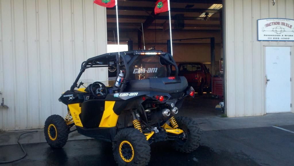

By far my favorite setup so far! Did you run all your wiring through your cage? And did you make the overhead console? Bad ass, man! :)
Thank you sir!
Spent a lot of time planning and acquiring parts to make the install clean. I had my buddys at the sheet metal shop across the way bend that channel for the console and I cut all the holes, trimmed, and welded stuff up.
I did not run the wiring in the cage for a couple of reasons......There weren't that many cables to run since what mounted overhead pretty much stays wired overhead, the rear wind net hides it all pretty well, I wanted the cage to be easily removed for service if needed, and the wire/cable sizes needed would have required larger holes in the tube than I really wanted.
I ran an 8ga pair to the roof to power the light bar, radios, intercom, dome light, whips, and reverse lights. The Ipod was a temporary solution that was replaced by the Lowrance Sonic Hub stereo mounted above the glovebox. I had to run a cable from the low voltage output up for music input to the 686 intercom. The speakers were included in the package, so I put them into some home made pipe cap pods that I sprayed with bedliner.
