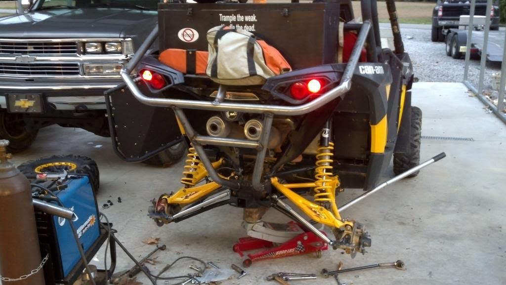

Here in the moutains you better have a chain saw unless you don't mind having to back track some. That is why I had to find a place to carry mine. I also wanted to be able to pull out someone if they break something on the front end and have to be lifted up to be pulled out. So that ment building a rear bumper. We usually carry tie rod ends but we don't carry steering racks. So you get the picture. I can run their winch cable behind the bumper and up and around the chain saw mounting tube and back down to the hitch where I will mount a clevis. The tube just below the mufflers should keep them safe. I still have a little more work to do before it gets painted. I also have to cut the tubes going to the cage and install ends so I can remove it if needed. Oh, and the box doubles as a cooler. About 12" of the left side of the box is a cooler. It will hold a case plus a big bag of ice and is insulated.
