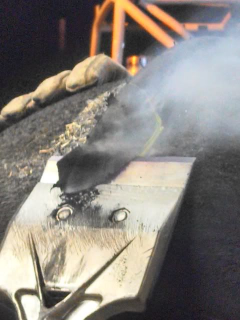

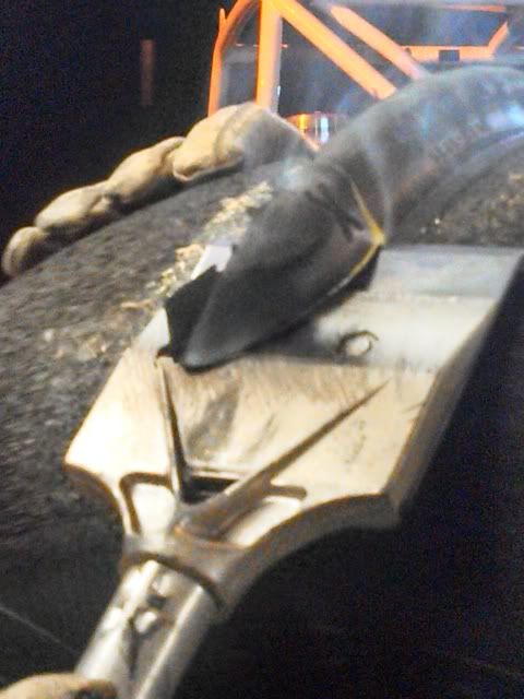

i used a metal floor scraper i got from Harbor Freight. I heated it up to cherry red and carefully trimmed the paddles to my liking. I trimmed off 20% of each paddle in a staggered pattern.

Grinder wheel of death, used to smooth out cut

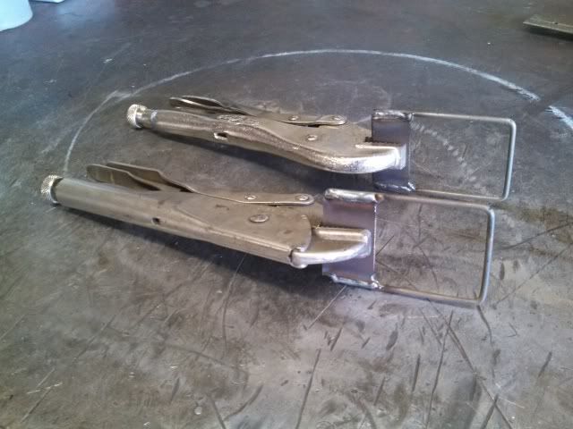

this idea did not work out. I bent some 1/8" solid rod and welded it to a piece of metal and held it with vise grips while heating it cherry red. Without a sharp edge and little material they cooled off fast and would not cut more than 1/4" at a time.

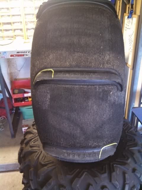

Layout
cutting

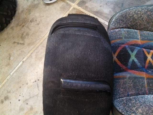

all trimmed up and ready for sand

Yeah grinder wheel-o-death is close enough. Some of those rock bouncer clowns cut theirs with chainsaws, but that's a 42" swamper.
Does it make a noticeable difference to groove a paddle tire?

Those are skat extreme right? I thought only those big ol Stu's need a comp cut.

i will find out friday this week in Glamis. I am thinking 7.5 paddles are the ticket. Glamis Fan said 8 was a little too much paddle.
Any concern of the paddles tearing now as they have a flat edge to catch?
will have to see, worse case i will have to buy another set of tires.
Skat Extremes yes, its my own thinking that the staggered Extreme is a good combo. Comp cut is when they shave down the carcass to save weight, staggered cut is usually 80/20, 75/25.

I thought my 8 paddle extremes were too much paddle at first too. After my first ride I was ready to get rid of them or send them to be cut down a bit. By the end of the weekend I loved them. I just bumped up the PSI a bit and ran them hard.
Nice trim job!
