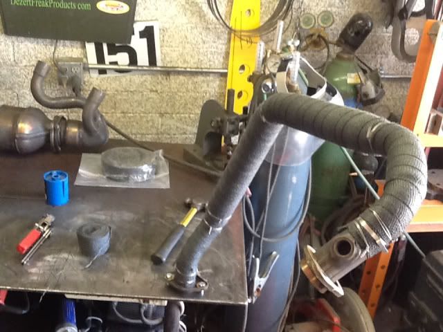

i bought two 50' rolls and have half of one roll left to do the resonator/cat. I soaked it in a bucket and wraped it super tight. I used stainless wire and some stainless cv boot ties to secure the ends and tight bends.
now i will let it dry for a few days and paint it with DEI header wrap paint to keep the dirt from soaking in.
What u mean u soaked it in water? Plan on doin this to mine tomorrow
When you dip it in water, it loosens up the fiberglass material. While wet, the material can be wrapped tightr much easier. It also helps keep the fibers down.
Cool....thanks for the info deff try that out tomorrow!
Don't forget to use the DEI silicone sealer. The more the better. It soaks in the wrap and hardens so it will help the wrap last A LOT longer. It will smoke a little for a minute when you restart but that's normal.
