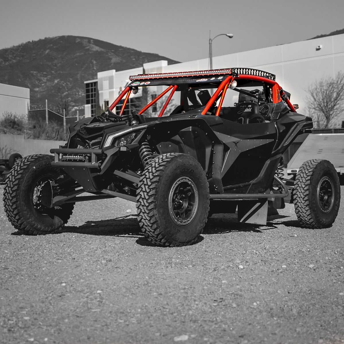

Had a change in plans. My local guy broke his foot and is backed up for a while. Thad from Fabwerx got back to me today and was able to fulfill all my requests. 3” taller than his normal cage, so about the same as stock or slightly taller, getting the boxed B pillars (my personal favorite feature/design of their cage), tilted whip tabs and tabs on A pillars for BD pods (XL80 or LP4’s) and powder coated in my custom color. They will be installing it for me on my way to Glamis (from nor Cal) toward the end of the month. Super excited.
#20 ·
Not sure if they fixed the picture issue but figured I’d update and complete this cage thread. I love how it turned out and got a couple extra surprises in the end. I wasn’t expecting the lower windshield deflector and the B pillars are a new design. Not sure if they are going to stay that way for the taller cages but I like that’s it’s a little unique for now. Looks like the pic issue is still ongoing but I’ll try again later.
