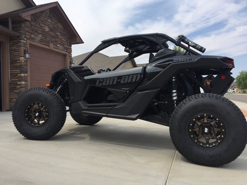

Just joined the big tire group..................
32" Maxxis Carnivores
14 x 7" (5/2 offset) RM Tusk Teton Beadlocks
Mounting tires on beadlocks was pretty straight forward, sealed up nice. Got them mounted on the machine but ran out of time to test drive. Width is now 66", should still be able to clear gates, and ground clearance is 16". Can't wait to take a test rip!
