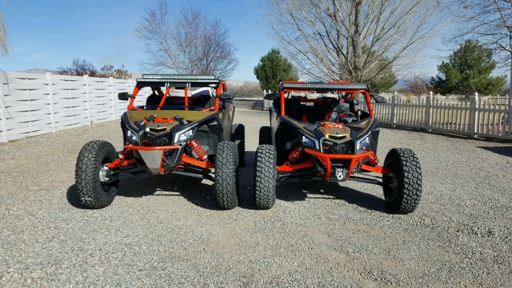

#221 ·
View attachment 134954 32 outback max on sti 17 inch rims. Of coarse they are 5+2 so no clearance issues. 1800km .. no belt issues, no clutching. Measures out at 17 inch clearance and 68 width . LOVE IT!!!!!!
So I looked up your tire spec. It shows 52lbs on the tire. You say no issues. Reading the forums a lot of people talk about tire weight being a serious issue to the belt and performance. Have you seen any decline in power or quickness? I am looking at an EFX steal belted radial in a 32 that is rated at about 46-48 lbs. The tire looks great! I am tempted to try it. I have not seen many steal belted radial tires for a UTV. Thanks

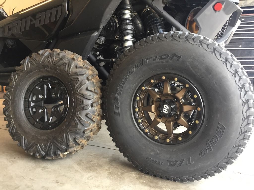

#150 ·
Ride is in the shop for it's 6000 km service. Getting new tires on at same time. Going to try the BFG KM2 33 x 10.5 x 15 this time. I am using the HD5 Beadlock and the shop is telling me they cannot get the BL on due to the extra width of the BFG's. There was no issue with the Chicane RX tires, but being as the BFG's are true truck tires they are thicker. Is the solution as simple as getting longer bolts to mount the BL?
#157 ·
Thanks for the reply. Another member running same size tire but different brand said to use a few longer bolts to compress bead and then the original bolts should work. I will try that first and if that works all good. If I am not happy with that scenario I will just use a slightly longer bolt as suggested. One way or another they are going on. :smile:
