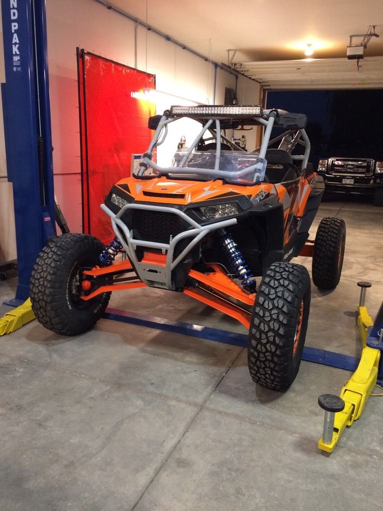

In Havasu I’m running 35 tensor’s in a rs max and plan on doing the APT in October. I’ve ran out to Lake Alamo and they work great. Running Douglas wheels. Tricky part is what air pressure to run I started at 20psi and now down to 15/16. I would run 2 sets one for Moab and one for desert.
in my 2005 LJ Rubi I run 35 bFg muds for Moab about 8psi works great! Havasu run 10/15 psi depends on trail / street. Haven’t taken the max to Moab
