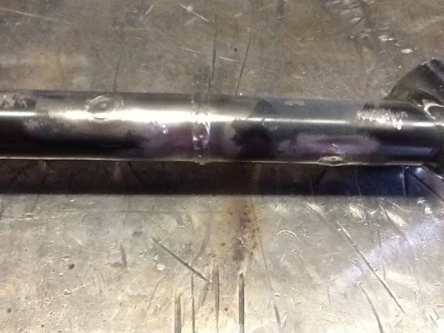

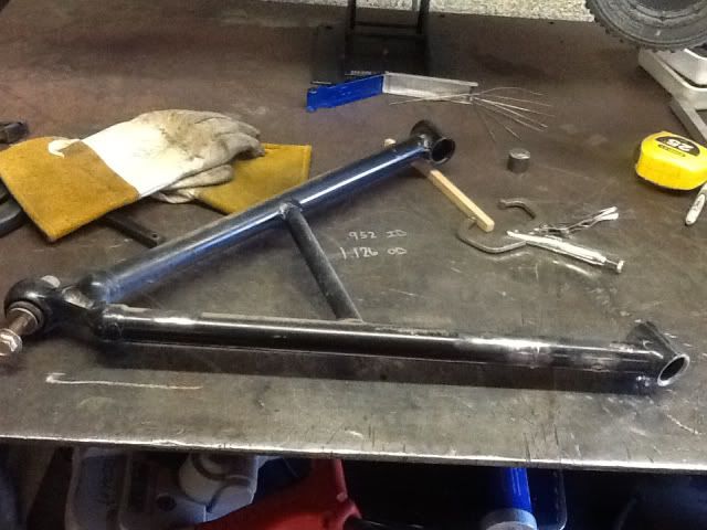

press straight
cut in half
drill rosette holes
slide in 15/16" od tube
tack
check for straightness
weld out
bent like a mofo
