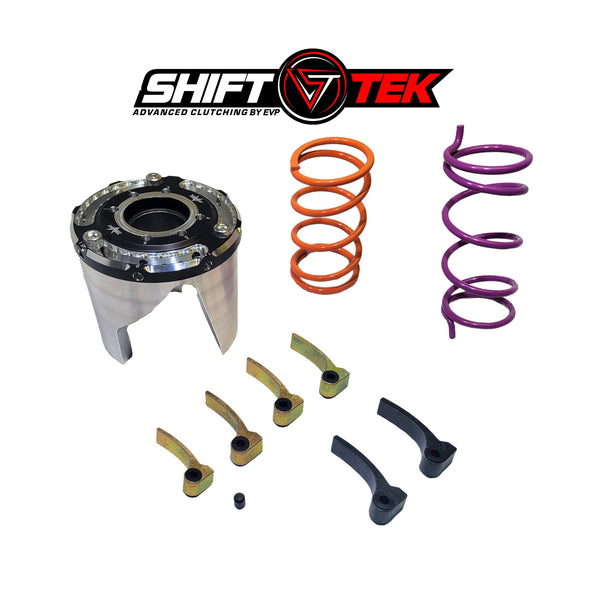

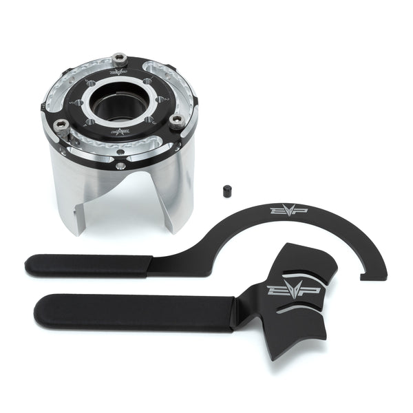

are evo springs good? my can am has 250hp(estimated), i saw the springs that hold 275+, it will be enough to hold.
#15 ·
taking advantage of the topic, I would like to post links to evo products that I am thinking of buying. I had to send my maverick 450km away, so I'll leave the necessary time idle to make my transmission 100% reinforced.
(ST-275 | 2017-21 | 250-275HP)
in my understanding, this kit is a complete kit for primary clutch. but I saw that the rollers are not coming.
secondary springs, it seems there is a difference in torsion by the colors. the purple one is medium twist, says it can handle +275hp
helixes evo, nothing much to say. since I'm reinforcing it, I think it's worth buying
secondary rollers, which are all broken
where do i find the primary rollers?
#16 ·
The ultimate clutching package comes with the helix for the secondary so you wont have to buy it individually. I recommend ordering that kit by phone so you make sure you get the weights you need and the helix angle you want for the power you have.
The purple spring should be great but since you're on the phone for the other kit already, double check with them.
In regards to the rollers you chose.. I have those and think they are good but their pins use a different bolt size (if you ever have to remove them) than even their own tool comes with, which is something you need to be aware of.
