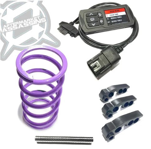

- Powervision flash tuner reprograms your ECU in roughly 8-10 minutes & easily installs by plugging into your diagnostic port
- Easily return back to stock, switch tunes, or upgrade tunes at any time
- A great gauge (see live boost and more) and data logging device

- S2 kits include our AA Recoil magnetic adjustable clutch weights, our primary spring & setup guideline.
- Our setup guideline will let you know how to set your weights for stock horsepower to 200rwhp, 28" - 32" tires, 28-32" paddle tires, different altitudes & more.
- Fully adjustable magnetic weights are easy to use, and with our special tool are also easy to adjust
- Adjustable from 50 to 64 grams. Weights have more tip weight and act heavier. This means they also accelerate and up shift much harder.
- Cooler running belt temps from a more efficient power transfer which results in longer belt and clutch life. With this kit and our Stryker belts (gboost belt) we have ran thousands of hard miles in the dunes & trails at higher horsepower with ZERO belt failures.
- Close to stock engagement which is very smooth (Higher engagement springs available if needed)
- Select your exact year/model which lets us know what weights to send you as the clutch casting is different between some years and models. 2017 X3's and 2018 120HP Base X3's (Kit 108-1008-A) use the same casting, while 2018+ 172HP Base X3's along with 2019+ 120HP (Kit 108-1008-B) use the new style clutch casting. This is a very minor change, but our weights needed slight modification to work. If you upgraded your older style casting to a new one, please let us know in the order notes.
- Our Recoil clutch weights are easily adjustable with simple magnets. They have a custom AA profile, the BEST coating on the market(nitrocarburizing) which has increased wear resistance, improved fatigue strength, and added surface lubricity. These clutch weights also offer great performance, and the ability to tune for many different applications or modification in the future, without the need to buy extra parts. The magnetic weights are the best option to properly place the mass where we need it on the weight for best performance for your application.
