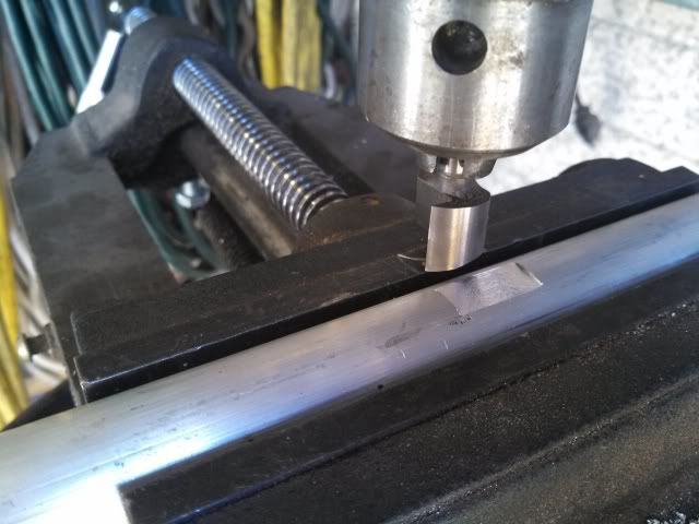

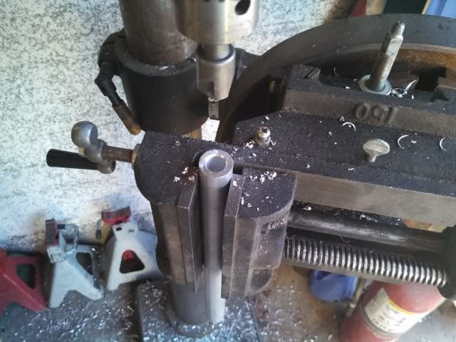

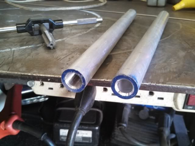

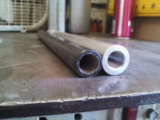

i spent $6 at the local metal suppy shop for 34" of 7/8 6061 aluminum solid stock. Then cut them to length and rigged them up in my drill press. Drilled 1/2" holes 1.75" deep in each end then threaded them to 14mm 1.5 pitch. Next i put some flat spots on them for a wrench and installed them with 1/8" toe in. Very easy and cheap thing to do.

Looking like a regular machinest. I bought some solid stock from Speedy Metal on the web. I think it was $4 for 18"
