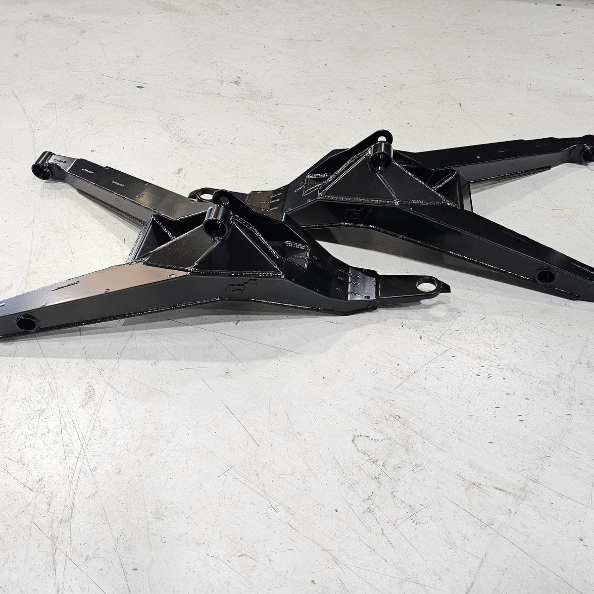

I’m tearing mine down right now for new lowers and some other things. I have the gusset arm on one side and a new supposedly strengthened arm without the gusset on the side I replaced. The new one to me looks just like one of the original non gusseted arms. It still has the fold spot on the rear bar everyone should be familiar with. I’ll get some pictures once they are off the car. Can Am has always designed fail points into their lowers, I wouldn’t bank on the new ones being much better.

These are the ones you are installing?
Yes, @craigstumph with Pro UTV Parts or @DBrunton with Ct Race Worx can help you with pricing and they have a sale for Labor Day. Both are great to work with and have saved me a ton of dough on my builds.

And you can see in these pictures the arm failed in multiple spots. The tip near the ball joint split open. My RZR, Honda, and Can Ams all needed upgrades. They are all weak stock. I’m not babying the car put putting around on fire roads but also not out doing KOH impressions either.

View attachment 330532 View attachment 330533 View attachment 330534 View attachment 330535 View attachment 330536 View attachment 330537 View attachment 330538
Looks alot like the A Arms on my '18 X3 when it was totaled. Unfortunately, the frame mounting points got bent compromising the frame. Now I shop for another...
