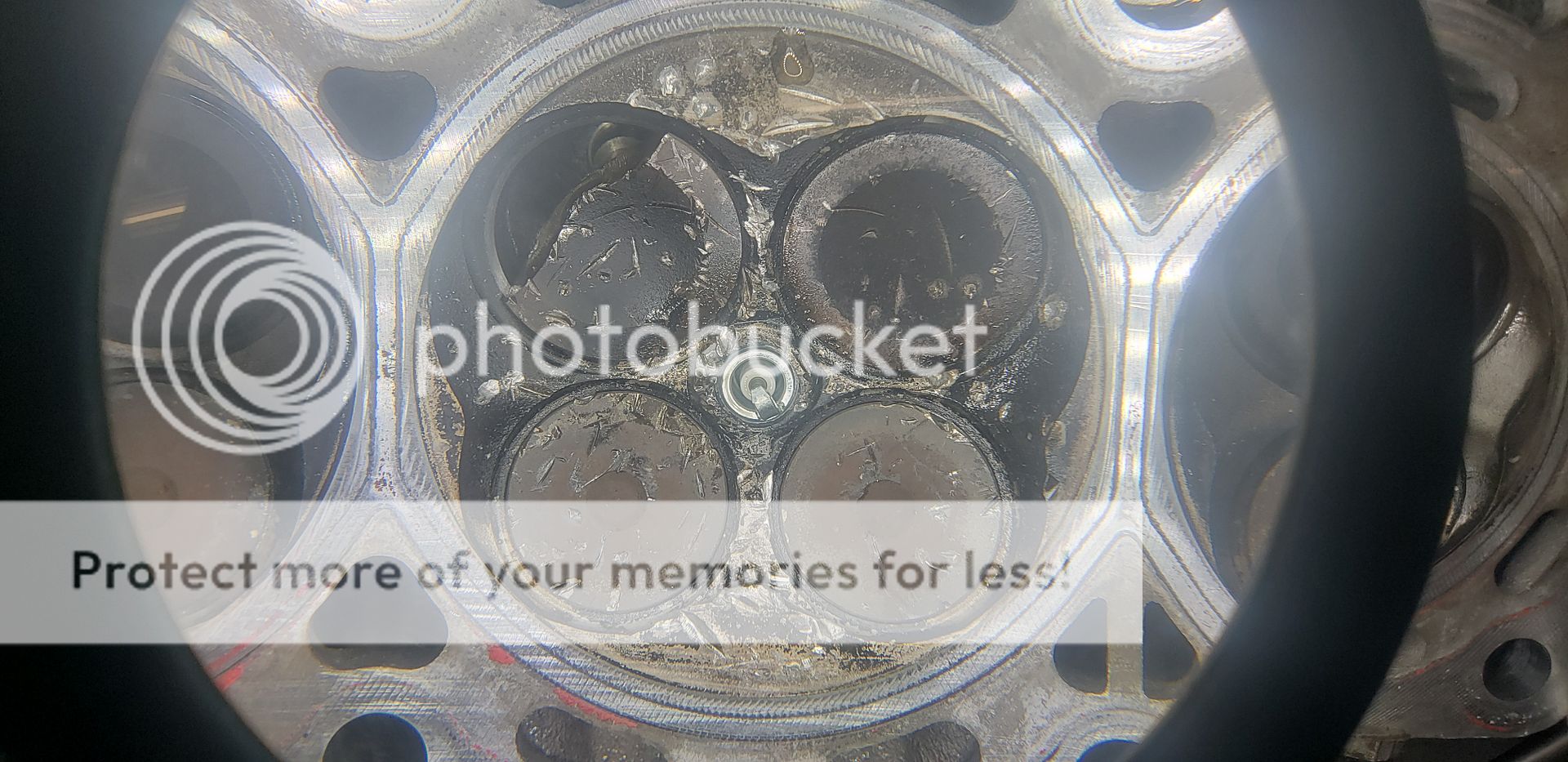

Figured I will start my own thread so people can give advice or comments, or correct me if they see something that should be done different for a better experience. I have worked on SXS for 8 years and Can Ams are not new to me, but always stuff to learn and things get better all the time. This build is a 2017 X3 that my buddy recently bought and it broke in Glamis. He brought it to me thinking something simple but only to find the worse.

So this will get a new head, all new valves, valve job, camshafts, dynimite turbo kit, head studs, billet intake manifold, block, cp pistons and rods, sb air filter, clutches will be sent to KWI for what ever they recd, belt temp gauge, and what ever he dreams of next. All performance parts will be EVO or sold by EVO other than clutch.
